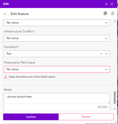

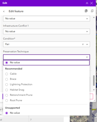

Error 1: “Value should be one of the listed values”
When I click on the drop down, it tells me:
If I blank out the selection, it clears the error:

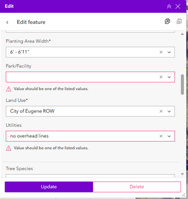

Error 2: “The selected feature has hidden fields with invalid values”
The funny thing about this one is that these fields are hidden because they are not relevant (based on previous responses). These fields SHOULD NOT show up on this feature at all, so it doesn’t make sense why we’re getting this error for the hidden fields.

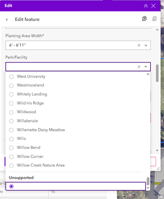

Error 3: “Value should be one of the listed values”
This question is a multiple select in Survey123. I know there are limitations with the Edit widget and multiple-select questions right now, but we’ve never had this issue come up purely from previously entered data from Survey123. It’s like when the response is viewed in the layer now, it just cannot accept the previously entered data.

@MollyBurton is it possible to get a repro case for Error 2?  You can DM me.  If the map is publicly shared, I just need the link otherwise, you can invite my user "craig_sp" to a group with the data.

My customers just told me that they have been experiencing errors 1 and 3 since the update. On error 3, even when there is no value at all, it is saying that "no value" is unsupported or it will show it as completely blank and say, "value should be one of the listed values". I was able to duplicate the issues. We have historic values that are no longer in the domain value list that need to remain as they are. Because it is essentially making these changes required, we are unable to continue updating data as needed from Experience Builder. Field Maps is not having these same issues.

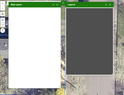

Additionally, not mentioned above. The app is significantly slower and has glitches like pictured below. Widgets will just be completely blank. The only way to fix it is to clear browsing data and log back in. Feels like all I have been doing is fielding complaints about performance and glitches this month.

@ToddJohnson We're targeting a fix for issues 1 and 3 mentioned above. From your screenshots, it appears that the fixes we're working on will address your issues but without a reproducible case, I can't say for sure.  If you're able to provide me access to your data, I'm happy to test our fixes against your maps/data.  You can DM if this is possible.
As for the other issues with Experience Builder, I'd suggest logging a Support issue for this so it doesn't get lost within this post.
