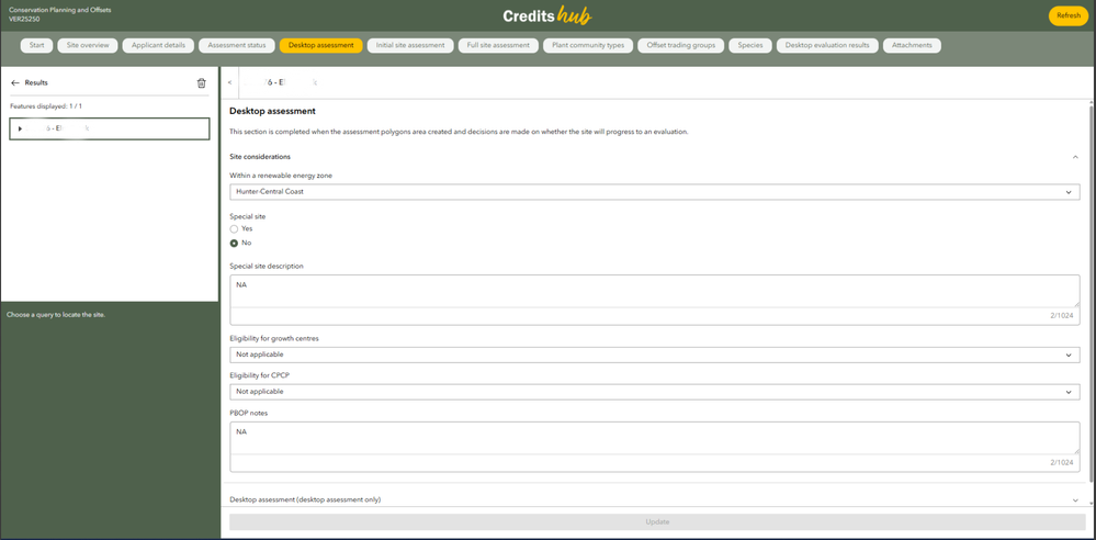

Below is a screenshot of the information entered before clicking on Update.

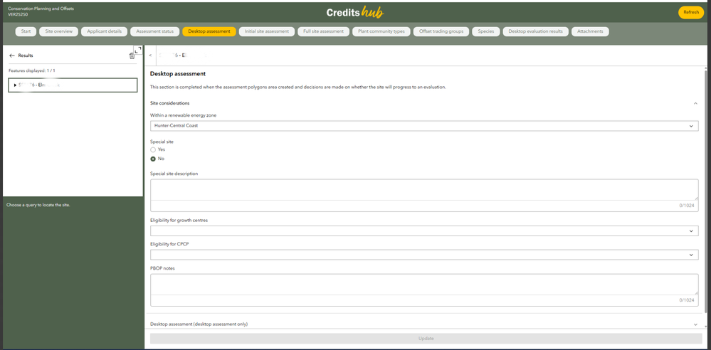

Below is a screenshot of the information after clicking on Update, moving to a different section and the coming back again.
