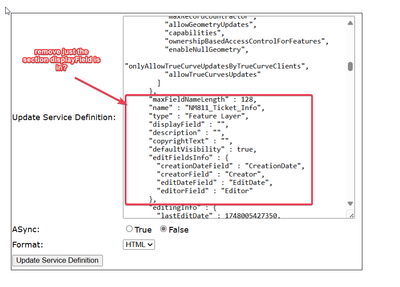

Good morning!
If you don't mind verifying your process, when you said removing all other content within the service definition. Is it just the section where displayField is currently located, or entire info of the service definition? Mine seem to have a lot of info in it. 
KatieHansen_NIFCAdmin
When you are updating the Service Definition, if you clear out the entire definition content box and then only add in what you want to update (which is the field that you want to be the header), literally just this:
"displayField" : "your_field_name_here"
and click Update Service Definition button, it will only update that specific piece of the layer's SD.
mattCSimon1
Thanks Katie! I think there's some confusion with the instructions since they direct you to search for displayField and the first instance of that is in the UpdateDefinition section. Changing it there doesn't work but changing the displayField in the next section (as the instructions show) and then changing the lastEditDate DID work so kuddos!
