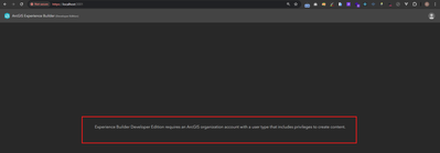

I have installed experience builder 1.14 in my system, trying to use the developer edition with my ArcGIS Online account, but getting the below issue.

Hi Saxina,
Please use an ArcGIS organization with a user type including Creator, Professional or Professional Plus to create ArcGIS Experience Builder.
Thanks,
Ke
