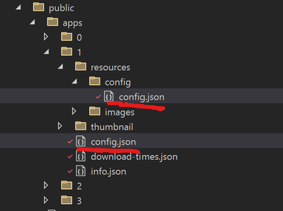

It will be referenced in both of these files in every app its used in. Good luck!
Edit: Maybe starting with a clean download of Experience Builder would be easier.
