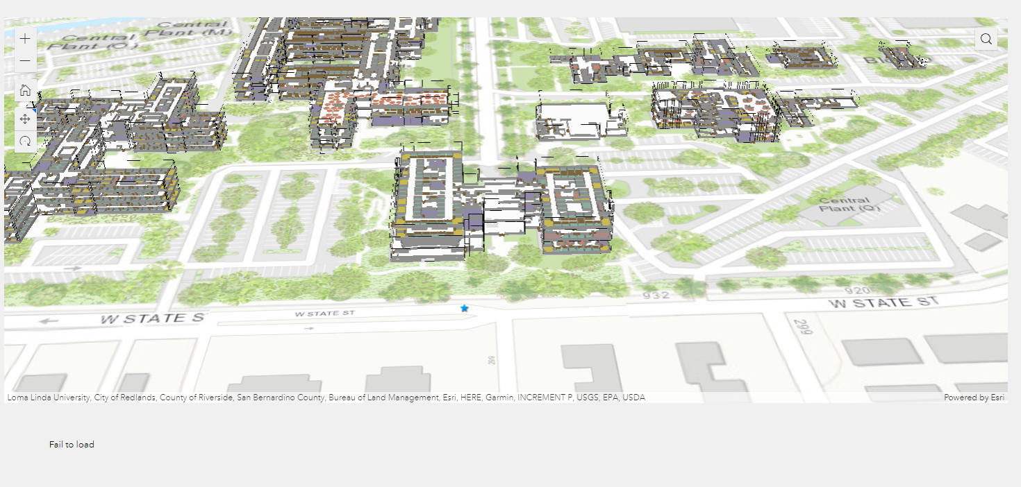

I've been creating digital twin solution for my client using fly controller. All seems work well in builder mode. However, when I download the app and deployed to static server the fly controller cannot load.
Muhammad_AzhaziqBin_Mohd_Azlan_1-1634033480855.pngMuhammad_AzhaziqBin_Mohd_Azlan_2-1634033493263.png
Anyone face the same issue before? The scene I used to connect with the fly controller is esri campus map scene in AGOL.

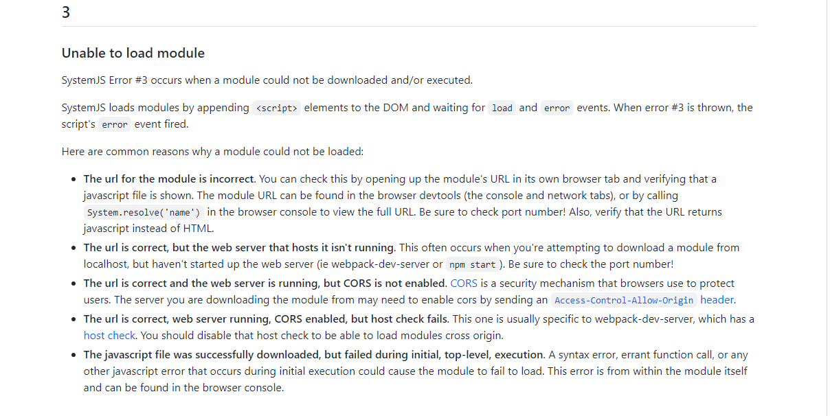

The jimu-for-builder package is not in the download zip, please copy it from client/dist to your download app.
This bug will be fixed in the coming 1.6 release.

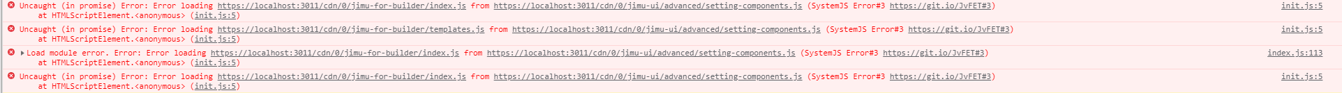

@Muhammad_AzhaziqBin_Mohd_Azlan Telling from the errors, it probably has nothing to do with the Fly Controller widget but rather some other parts. Tried to reproduce but was not successful, unfortunately.
The error indicate jimu ui couldn't load jimu-for-builder.  I don't have access to the raw code of the jimu stuff. Couldn't debug further.  By the way, which experience builder version you used? I still can replicate the issue I even changed to difference scene "Esri's Redlands Campus in 3D" in 1.5.
TonghuiMing
Thanks for pointing out the version. The issue can be reproduced in 1.5 indeed, while not others or the upcoming one. Will take a look at what happens here.
