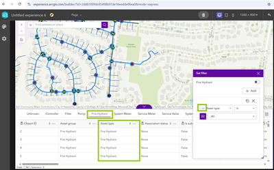

I recently created an app that will help our engineering department do simple filtering and exporting of our Utility Network dataset without having to request data from our GIS department. However, the table widget does not appear to be able to read all of my domains. Some of them are translated and others are not.

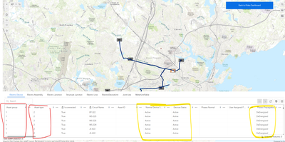

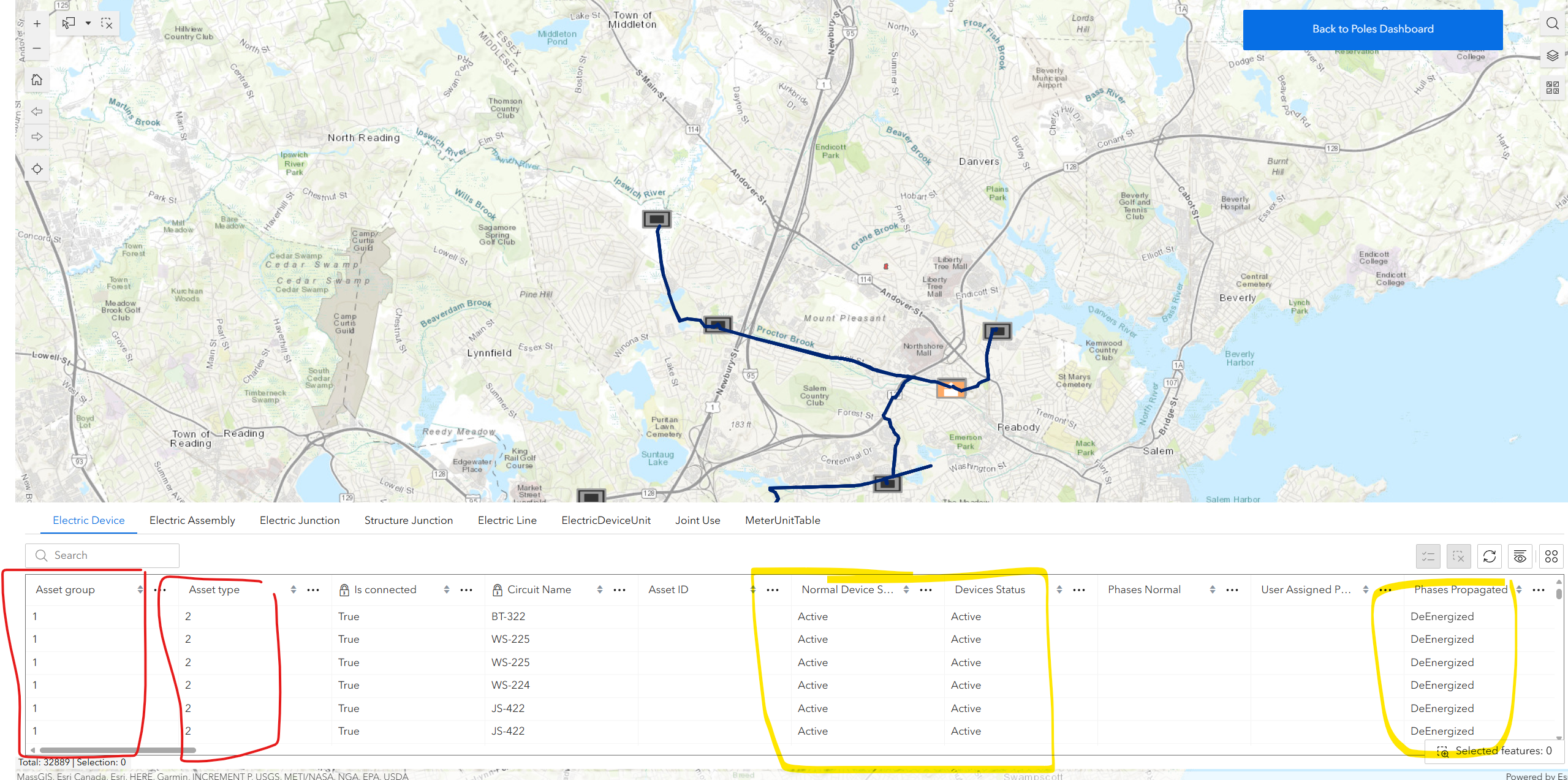

Below, the yellow are ones that translated and the red are ones that didn't.
Am I correct in thinking that there is no way to fix this within Experience Builder and that the solution boils down to "don't have domains"? Is there anything I can do to force the Domain Values to appear? All of our Utility Network Feature services will of course have domains.

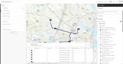

Could this issue be reproduced in List widget? In Map Viewer, does the domain value display as expected?
Thanks,
Ke
Ariggs
Hi Ke,
Yes, the issue is the same in the List Widget and in Map Viewer, it appears to be native to the feature service itself. My colleague said to me after I posted yesterday that the issue of some domains doing this when published to a feature service while it translates others is a known bug. Unsure whether that is intended to be resolved soon?
