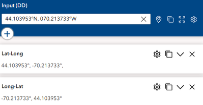

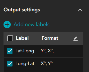

Hello @WinyamaAdmin  , in the Output Settings section, you can Add your own New Label. And that can be configured to have a label such as "Lat-Long" and show Y, X etc.

ChrisUnderwood
