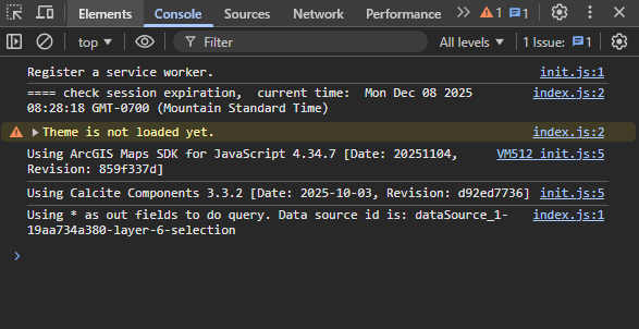

I have other ExB Dev apps that are launched on an internal server that do not have this issue, so I'm wondering if that may be the next step to take. I can't post the link here yet since the tool is not public. This is all the console shows:

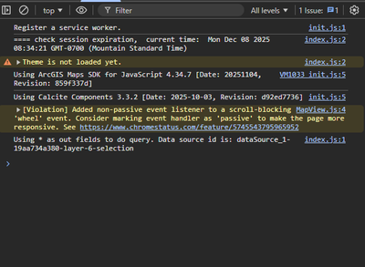

*edit for the console image:
This passive event listener warning pop-ups sometimes when it's frozen: https://chromestatus.com/feature/5745543795965952

Hi, just an update: despite a few troubleshooting attempts, it turned out that the report widget made my app unusable once it was published. I ended up removing that widget, generating the reports in bulk, and then attaching them to the shapefile. Luckily, my data is static, and this solution did the trick for our workflow and timeline.
