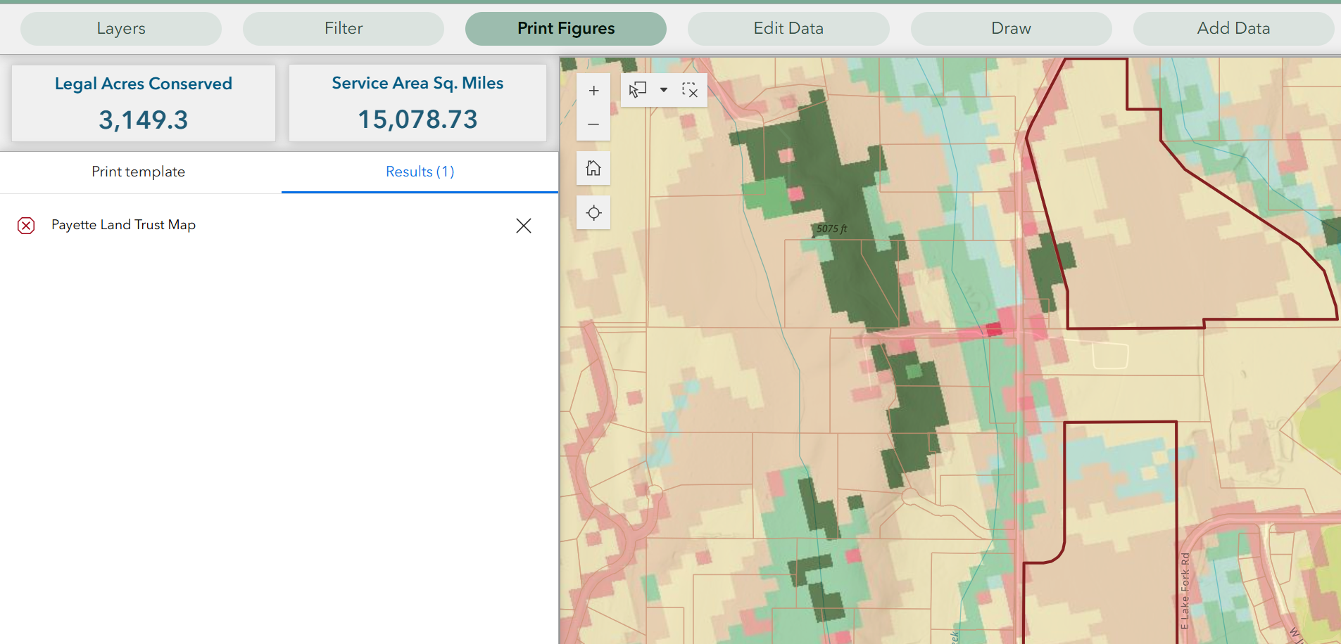

I have been using Experience Builder in ArcGIS Online since its inception. I have a non-profit client who I created a dashboard project tool for 2 years ago that has allowed them to export maps for their baseline reports. All this time they have been able to print to jpg or pdf when premium content is turned on and suddenly this has stopped working and every time we try to print with preimum content turned on, the print fails. If we turn the premium content layers off, the print works fine. What is the point of having access to Living Access layers if we can't utilize them in our reporting and analysis? Is this a bug? Will this be fixed with this weeks update?

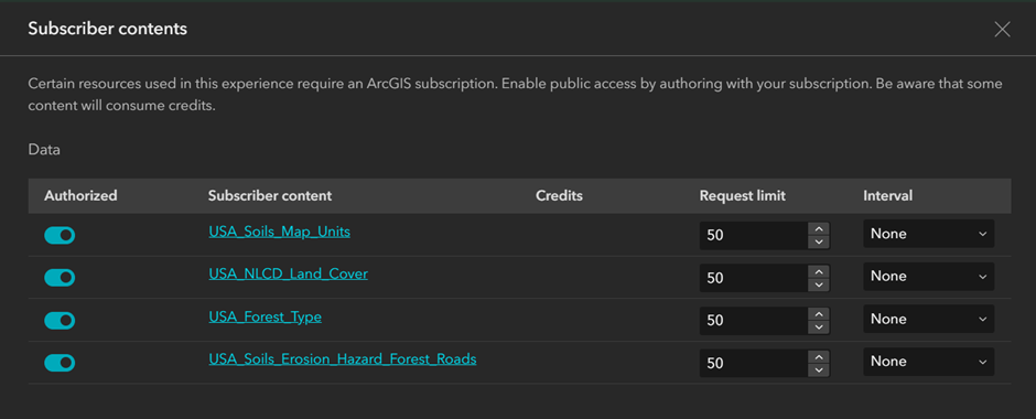

Premium content layers that are approved by the organization when publishing the application:
With NLCD land cover turned on:

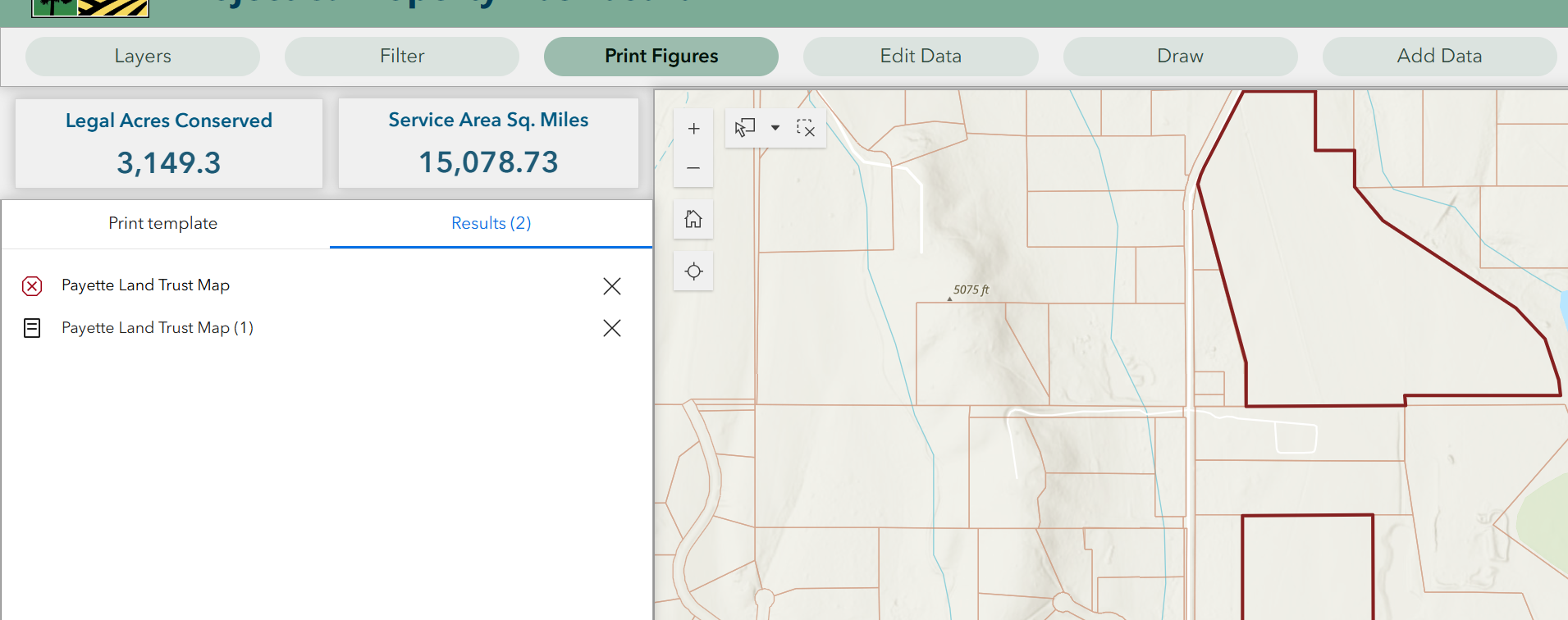

with NLCD turned off:

Hello @ShengdiZhang  and anyone else following this post. I have solved the issue: The premium content was authorized for public viewing in the Experience Builder application even though the Experience Builder application is not publicly shared. It's only for internal staff/organization use. So, I un-authorized premium content for public viewing and that resolved the issue with the print widget not printing when premium content layers were turned on.

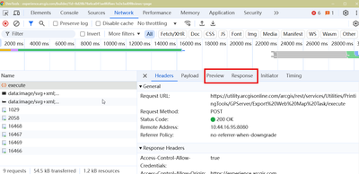

Can you open DevTools and check if errors are showing up in the console and on the network?
