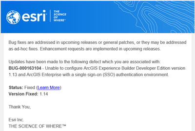

I got an email this morning classifying this bug as officially fixed, which isn't exactly true. It will be fixed in Developer Edition 1.14 when it releases next week. If you would like to be alerted for updates on bugs or enhancements the easiest way is to call ESRI support and ask to track the progress.

Sorry for inconvenience. We do appreciate your feedback. This issue will be fixed in the coming 1.14 release (Mar.20).

Confirmed this bug is now fixed in ExB dev edition 1.14! I am now able to log in with SSO.
