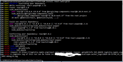

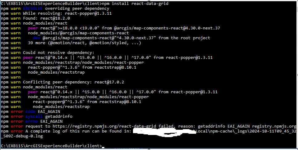

Hi all,
I am developing a custom widget and I need to use a react-data-grid. I have run "npm install react-data-grid" in the client folder and I am getting the warnings and error below
I suspect there is something missing in the published node cache zip (v1.15). Can someone from ESRI review please? The install process should not be trying to access an online resource as I am working offline.
