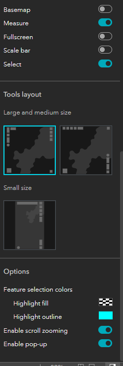

I am in an Enterprise 11.1 Environment trying to work with Web Experience Builder.  I created a Parcel Explorer for the public to search information on Tax Parcels.  It is still being edited for capabilities but the basic information is available.

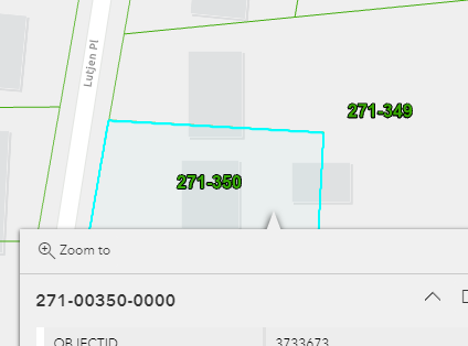

In the Body under Map I have toggled on "Select" in the Map Tools.  When I click on a single parcel in Preview it will highlight.

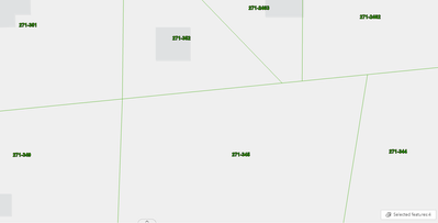

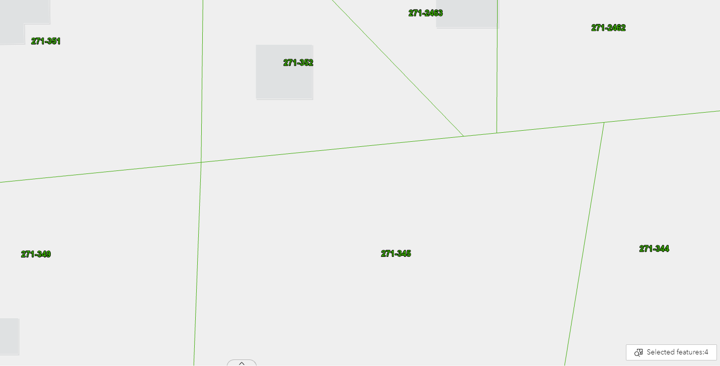

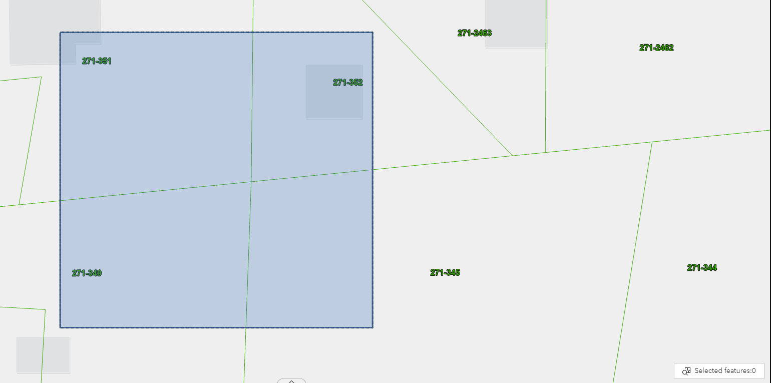

However, when I use the select tool (in this instance using the rectangle select)  it will say I have x number of Selected Features but it will not highlight them.  I even tried clicking each parcel individually while holding down the Shift key with no success.
GrantCountyGISSup_3-1713900736535.pngGrantCountyGISSup_3-1713900736535.pngGrantCountyGISSup_4-1713900770159.pngGrantCountyGISSup_4-1713900770159.png
I checked all of the configurations, tried removing and re-adding the data, changing the colors but nothing seems to work.  Is there something I could be missing?

While the map-click is affected by the map viewer configuration of the pop-up, the selection tool relates to whether this service supports query by geometry.

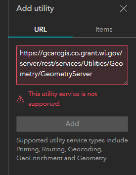

So I tried adding the Geometry query to the Experience but I get that it is not supported, is there another place I need to turn on the query by geometry?
**Update** I had to share this as public first in my content, now it adds just fine.  I still cannot get the selection tool to work, so there must be some other setting I am missing**

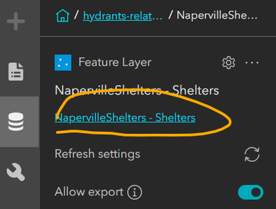

I was talking about the REST service capability - {hosteddomain/rest/services/{layer}/...}, not inside ExB configurations. You can access it through the data panel link of the used service:

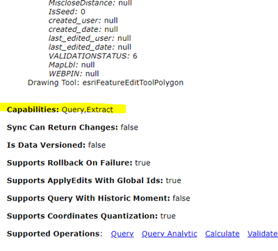

So I looked into my layers and tried a few things, from what I can see it map layers can be queried.  Initial I had a map image layer I was trying to query, this is how the REST looks:
GrantCountyGISSup_1-1714057101885.pngGrantCountyGISSup_1-1714057101885.pngGrantCountyGISSup_2-1714057123980.pngGrantCountyGISSup_2-1714057123980.png

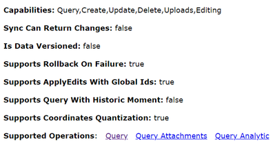

Then I published the same layer as a Feature Layer and here is the results:
I am not familiar with how to change this if these parameters are incorrect.  I tried the new feature layer in a test web map and attached it to the experience without any success.
