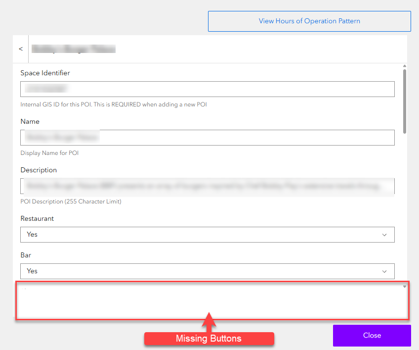

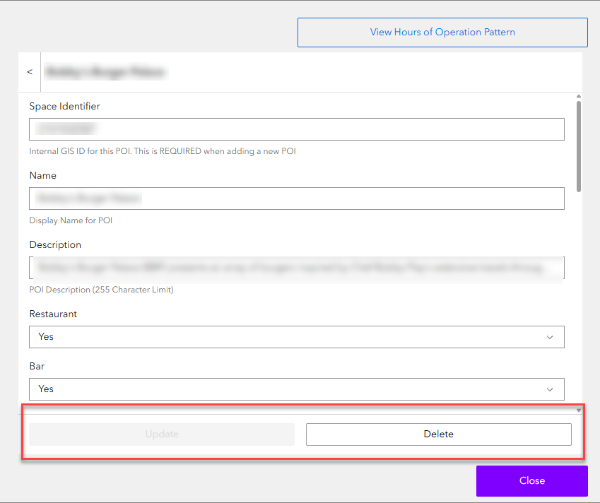

We recently upgraded from Enterprise 11.1 to 11.5.  I have made a few discoveries with functionality that I believe are not as designed. I am wondering if anyone else is having the same problems..
1) My edit widget loads in a separate window.  I have found that the "Update" and "Delete" buttons intermittently fail to appear on the widget. I have to close/open the window several times to get the buttons to appear.

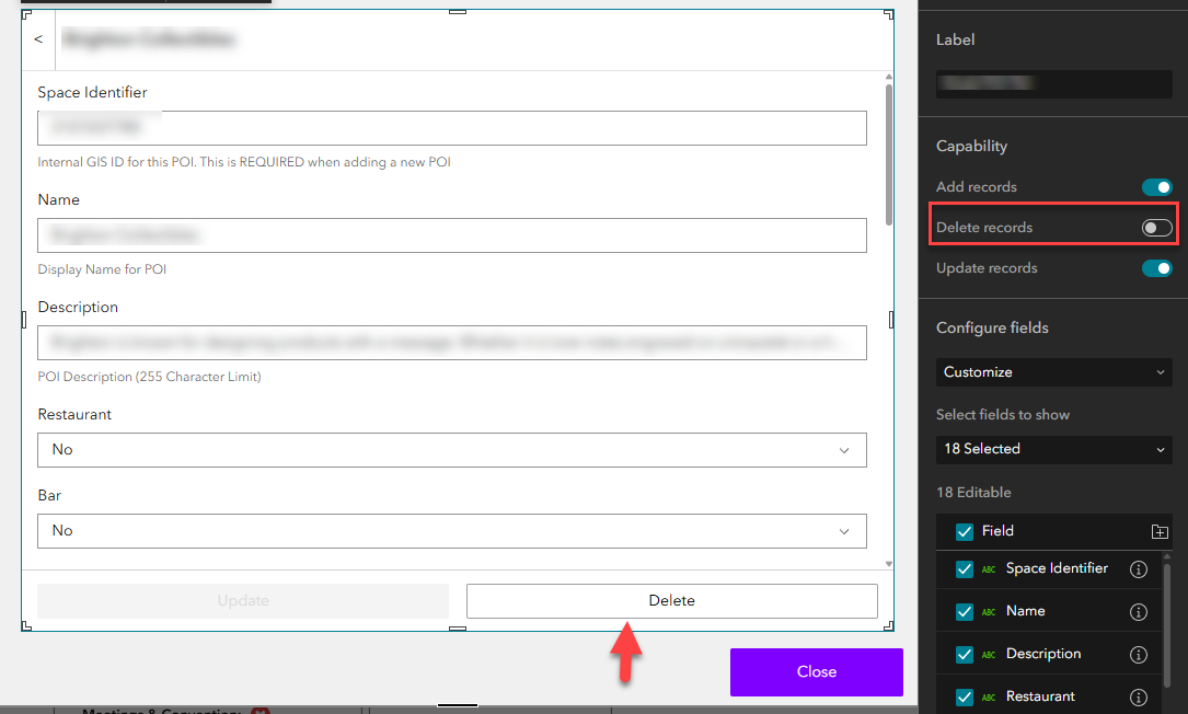

2) When the buttons do appear, the "Delete" button is visible and active even though the "Delete Records" capability was is toggled off in the widget config:

I reported this bug about a month ago and I believe it has been fixed. Should be in the next developer edition release. I don't think you can see this since it's my bug, but it's: BUG-000176215
"The Update and Delete buttons intermittently disappear from the Edit widget in ArcGIS Experience Builder Developer Edition 1.17."

JeffreyThompson2
MVP Frequent Contributor
When you say 'window', do you mean a Window or a Widget Panel in a Widget Controller? Either way, I think your issue is that the height of your Widget is a bit too small so that little variances in screen size and text is causing there not to be enough space for the Buttons.
As for why you can delete, are you an Admin or the Data Owner?

Andrew-Bowne
When I say, 'Window', I mean Window 😉
The Window is 815pxW x 750pxH and the Edit Widget fills 95%w X 85%h of that window.  So it's definitely not too small.
Delete Button:  I am an Admin but the Delete button shows for other non-admin users.
I think it's important to note that neither of these issues existed in 11.1.  Everything worked as expected.  This has only arisen after the 11.5 upgrade.

Andrew-Bowne
Sounds like BUG-000176215 is exactly what I am experiencing.  The issue with the Delete button visibility persisting?  Looks like I might have to report that one to support.  While I am at it, I will get added to your bug about the disappearing buttons.

ATuckwell
Just curious - how did you get around this? I have placed another element on top of where the delete button is and made sure delete isn't allowed at the feature service level. Is there a better temporary solution?
