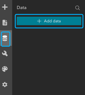

The webmapId is not the correct dataSourceId. Data source is a concept in Experience Builder. The only way to select a webmap/webscene data source is using the left data panel.
Then you can check the dataSourceId by _appState.appConfig.dataSources in the console.
