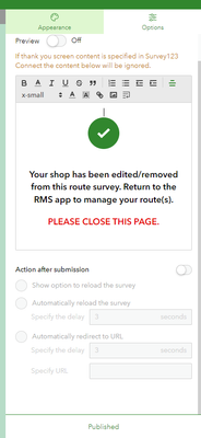

You can control this through the survey itself:
MikhaylaB
Is that an option if I've created the survey in connect?
