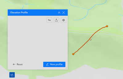

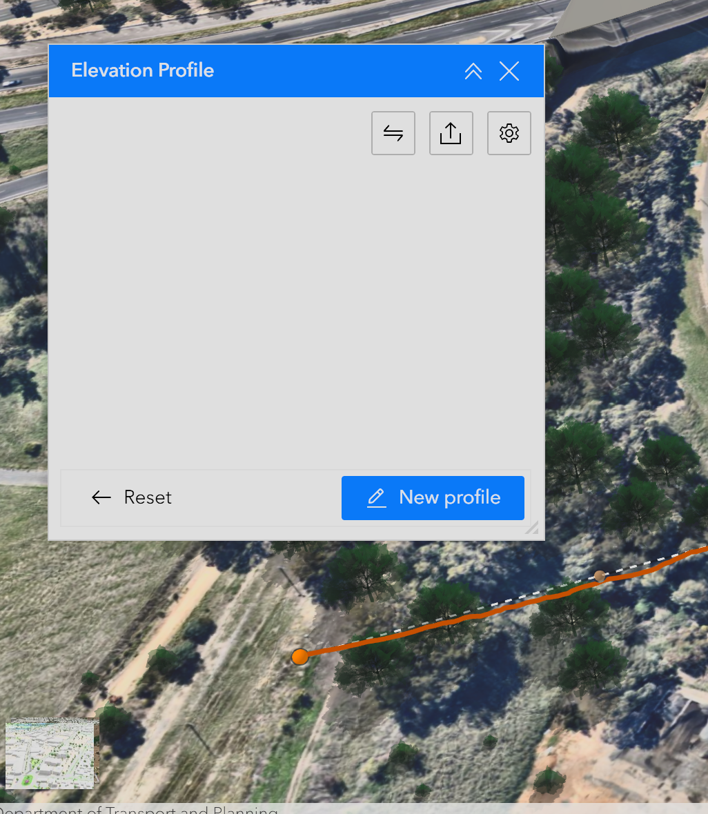

I added two scenes into one map widget. Everything works fine in draft mode during configuration.
After publishing the app, the elevation profile widget only works for the first scene. If I switch to the other scene, the elevation profile will show as blank.
Switch back to the first scene, works again.

On page 1, I added two scenes to the map widget with one elevation profile widget. Elevation profile is not working on both scenes.

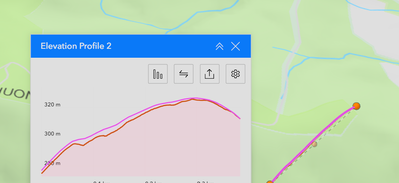

On page 2, there is only one scene on the map widget. It's one of the scenes from page 1; elevation profile can display elevation correctly.
