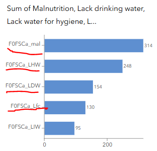

Hi,
I am presenting a collected data in experience builder using the bar chart and column chart. How can I change the labels of the categories/fields. I tried changing it in the source file in arcgis online, but it did not reflect in the experience builder.

Hi @carlureta_comp
Had a look in ExBuilder but can't see much in the way of editing other than making that chart bigger but if you want smaller labels maybe create new fields in the feature layer and copy the data across and display those fields in the chart instead.
Dev Edition might be more helpful or hopefully someone has a better answer than me. I could have missed something easy.

Hello,
Thanks for your feedback, but currently it is not supported in Chart to edit the label.
When you saying "I tried changing it in the source file in arcgis online, but it did not reflect in the experience builder. " Do you change the attribute table field name/ alias?
