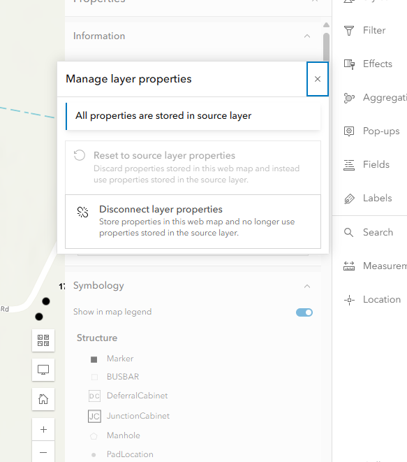

I am trying to recreate many of the Web AppBuilder applications- (as we all are) but my environment- is a mix of - Portal Content- Hosted Feature layers/ Feature layers content and  Published Views  - I also have editing groups- and the edit- function- seems to not- work- as intended /expected- and -- honestly--It  is confusing--  smart forms that need to be configured- but - that means you have to disconnect the Feature layer from the other-(see image )
seems- so odd to me- why can't we have the ability to create the smart form in the map that has the Feature class -since they are stand-alone items-- " maps "- From what I have read the Map level configured Edit "smart Form ' is supposed to work as an override to the Feature class  (that can have a standard template applied--)- (Think rock, paper ,scissors --)-   The map template is supposed to cover the Feature Class template-- not replace it- so why do I need to disconnect the layer  ? If I disconnect the layer- the changes to the main layer  dont flow upwards    and --if its a group layer-- which many of mine are--it is not an option ---so what am I to do with those ?

I wanted to update this- so that any facing the same issues - may see --  The Republishing of the Feature layer to your enterprise portal--sometimes-- resets the locked template- a few times it has not . If you have layers that were published with ARCMAP - if you republish with Pro  sometimes just republishing fixes it .
Disconnecting from the FS -- does not always unlock the template - and sometimes breaks the related records feature when the published layers are multifaceted. For the times it did-- I removed from map and re-added to the map --  and that-- eliminated this problem- link was restored.
I have now rebuilt 10 of the Web app builder apps for my org. Please -DO NOT WAIT TO REBUILD --start this process by documenting what the app does while you can still see the inner workings before WEB APP BUILDER Editing/Creation access is locked to you.The behavior of the forms configured in the map --to be used with ExB and the editing widget /selection tool - and the way that forms configured in Field Maps designer is still a bit different - from each other and dependent on what Enterprise version you are using .(same with Arcade expressions ) Know what profile you are trying to use and take advantage of the AI assistants if available to help you craft the expressions you need to make these smart edits happen -- Hope this helps someone and know when you see it is locked-- you can try -- a few different things that-- on the surface sound like they will break the connection with your DBO and your information ,but that- reconnection seemed to work most of the time - when that failed- Republishing the service worked  to restore the related records / table data connection. Arcade needs to pull images for the related records and hyperlinks to images.
