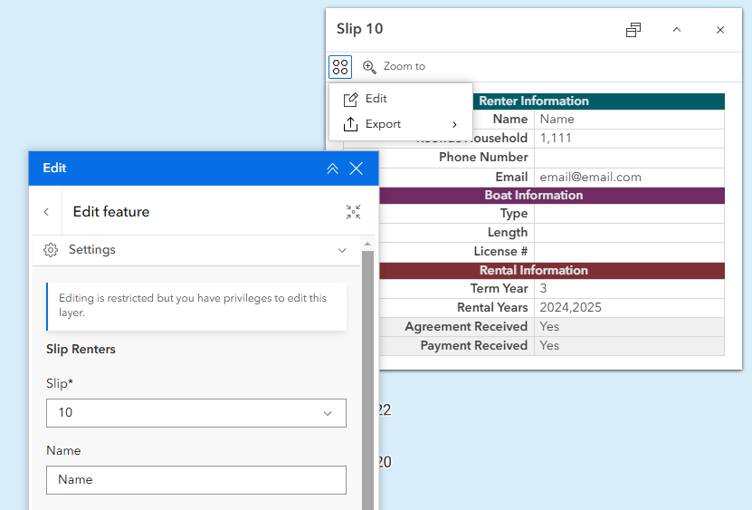

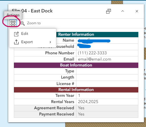

I have a web experience built for editing. Previously, the edit action was available in the pop-up.
screenshot from 2/4/2025, ignore red circlescreenshot from 2/4/2025, ignore red circle
The edit action is now gone, seemingly after the recent AGOL update. The layer is still configured for editing in the layer settings and in Map Viewer. Am I missing something, or is this a potential bug?

@Meredith_Keraga, I am not able to reproduce the issue. Where is the Edit widget located? If it is already open, the Edit data action on the pop up would not display. Is the Edit widget in Widget Controller? it would be great if you can share a reproducible sample. Thank you.

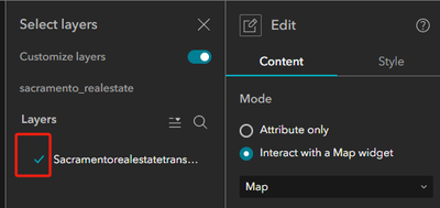

The "Edit" action verifies the layer's ID in the custom settings against the map layer's ID to determine whether it should be displayed.
Is the "Customize layers" option in the Edit widget toggled on?
I guess that somehow the action can't match the layer IDs.

@Meredith_Keraga Thanks for the post! In your case, it seems there is an issue with the previously created configure file, though the exact cause is unclear at the moment. There's no need to reconfigure all your widgets—simply unchecking and rechecking the affected layers in the Customize Layers panel should rebuild the configure file. Newly created apps should not experience this issue.
Let me know if this works for you. Thanks!

Hi @TianWen, thanks for the response! I tested this on a copy of the app and am happy to report that the edit button has re-appeared in the map pop-up. This will save a lot of time versus re-configuring all the widget connections!
