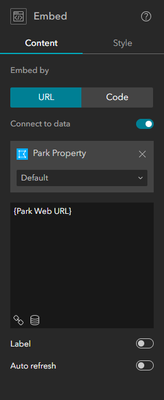

  1. Make your articles using StoryMaps or a blogging site.
  2. Make a Hosted Feature Table containing the URLs to the articles.
  3. Inside the List Widget, add an Embed Widget.
  4. Use Connect to Data and set it to the URLs in the Table.
