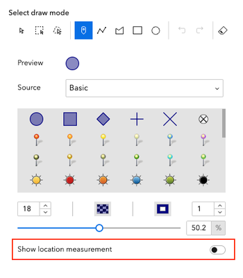

Hi @JoelMcKechnie
Do you mean Show measurement options are not displayed here?

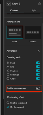

There is an option called Enable measurement in the draw widget settings. This option controls the display of measurement toggles in the draw widget. By default, it is disabled, which means that newly added widgets will not show the related options. Once you enable this option, the measurement options will become visible.
Could you please provide a sample app that exhibits the symptoms you described? This information will help us investigate the cause of the issue more effectively. Thanks!
