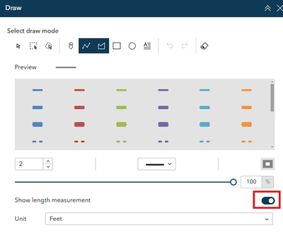

Hi
I can't see the ability to do anything with a drawing once it has been created.  Is this correct?  If the user wants to edit a polygon (eg edit the vertices) it appears this is not possible.  Equally, if they want to display measurements (and didn't originally click the show measurements toggle) they can't and have to recreate the polygon.  If they want to change to colour after they have drawn the polygon they can't.   This is really limiting as I believe most users wouldn't have all the setting correct before drawing a feature.
I am using Developer Edition EB but the out of the box widgets.
Thanks
Brian_McLeer
MVP Regular Contributor
Hi @GISNCC , I am on 1.16. The user has to use the arrow to select the existing feature that is drawn to edit a node or delete one specific feature.
I think you cannot go back and turn on show measurement for an already drawn feature, you have to have it turned on prior to creating the feature for the measurement issue.
Shen_Zhang
Hi @GISNCC, Thanks for reporting. There are some dependencies on the Maps SDK side regarding the post-editing feature, but we're working on it. Will let you know the updates!
