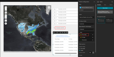

I'm running into an issue with using date/time fields in Dynamic Content in Text widgets in AGOL Experience Builder: When I use any date/time field as the source for a Dynamic Content value, the value does not display.
I know the values are there, because they show in popups and I can successfully use them to sort a List widget connected to the data. So I end up with a situation where there is a List widget with Text in the list item, both widgets are connected to the same data source, the List is sorted using a date/time field, and that same field does not show up when I use it as dynamic content in the Text widget.
This same issue is happening for every date/time field in the layer, as far as I can tell.
I saw a lot of posts about date/time values showing up without the time portion (not the problem I'm having), which was usually fixed by editing the layer's Field settings in a web map. I've checked the Field settings for multiple date/time fields in this layer, and they seem to be okay.

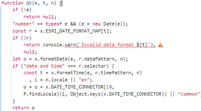

Bonus clue: I get this error in the browser console:

  1. I dug through the stack trace for the `Invalid data format undefined` error from the screenshot in my post, and realized that the function responsible for displaying the data in the correct format was being passed `undefined` as the format key, which obviously is not a known `ESRI_DATE_FORMAT_MAP` key. fdeters_0-1721943022702.png

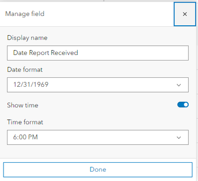

  2. I realized this must mean there is somewhere in the layer where Experience Builder is looking for a date format and isn't finding one. (I think this is a real problem - there should be fallback behavior when it can't find a date format, not just a blank display.) So, I went to the Visualization tab on the Item Details page in AGOL for the Feature Layer I'm working with, and changed both the date and time format settings to a random option, then back to the default so that it would hopefully record it as a custom setting. fdeters_1-1721943245960.png

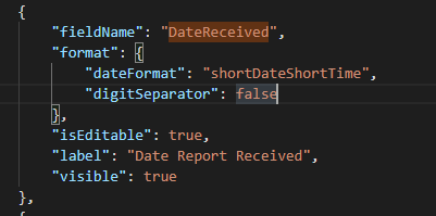

  3. Then, I saved the changes to the Feature Layer, and I saw this new `format` key show up in the JSON for that field in the Feature Layer (the `format` key was not there before I did step #2): fdeters_4-1721943371389.png
