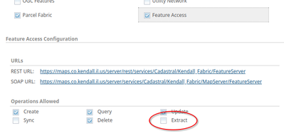

Is there not a capability to export data (to csv preferably) from a table in EB akin to what is available with WebAppBuilder?
It appears that this option may be available only with hosted feature classes. Ours are not. Can you confirm that this is the case? Will it be a feature in future upgrades? Is there a workaround whereby we can use a javascript api snippet to offer the user an export option?

I believe you need to enable the Extract setting on the service. Have you checked the capabilities of the service?
