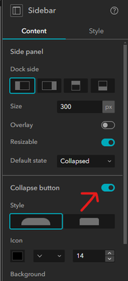

I fired up the Tab template and took a look. Your problem is that the Sidebar is collapsed and there is no button to open it. Activate the Sidebar Widget and find the Collapse Button. You should now be able to open the Sidebar and put your widgets in there.
Turn the Collapse Button back off when you are done.

Worked, thanks heaps!
