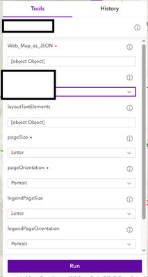

I just plugged in a synchronous custom GP print service into the Analysis widget and it displays all expected input parameters.
If you could share some screenshots or more details about your service, you may get more input from the community.
