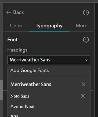

For everybody subscribed to this thread who has been waiting for CUSTOM FONTS in Experience Builder AGOL, THEY'RE HERE!!!!!!!!
Must've just come out in the October 2025 update. 🥳🎊🎉
ErikAIversen
Hi! I don't have these options under "Theme font". Where is the options you show in your screenshot located?
EDIT: I had to change the theme from my current one before I got these options. It was not enabled by default within the existing one I was using.
AlderMaps
Hi @ErikAIversen, same here, and I didn't realize choosing a new style was what triggered the availability of new menus until you mentioned it. Thanks!
Wei_Ying
Hi, the new font setting is available for the new theme. If your existing app is still using old theme (which is by default), this won't be available.
