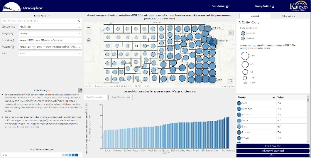

I came across this data explorer experience by the Kansas Dept. of Health in the ESRI Experience Builder Gallery, and I was wondering how they were able to add a color scheme changer like the one in the gif image below. This would greatly improve the accessibility of my experiences by giving the user an option to change the thematic colors. I'm assuming this might be a custom widget since I don't see it in the widget gallery. I would love to know if there is a tutorial somewhere that demonstrates how to accomplish this.

So it appears to me, if you right click on one of the dots in the right, and press F12 to open dev tools, you can then watch as the  color scheme is changed, you see the 'color' attribute hex code change
<div class="app-root-emotion-cache-ltr-ov1ktg">
	<div color="#2f7fbb" class="app-root-emotion-cache-ltr-1s9afiz"/>
	<div class="app-root-emotion-cache-ltr-cij0n6">Bourbon</div>
</div>
So, without digging more into their code, it would appear they have somewhere in code that is automatically assigning the attributes based on either some state, or props value which is based on the current selection from the color selector dropdown.
(It is a little weird because it doesn't remind me of HTML/CSS where you'd expect either a class name to change or a style="color:#somehex;" change within the Div's definition)

When I searched their source I saw this compiled (numbered) function:
9332: (t, e, r) => {
                        "use strict";
                        r.d(e, {
                            Actions: () => a,
                            useKdheDispatch: () => u,
                            useKdheState: () => c
                        var n = r(8891);
                        const {useDispatch: i, useSelector: o} = n.ReactRedux;
                        var a;
                        !function(t) {
                            t.UpdateFilters = "UPDATE-FILTERS",
                            t.UpdateActiveData = "UPDATE-ACTIVE-DATA",
                            t.UpdateSelected = "UPDATE-SELECTED",
                            t.UpdateTimeSeries = "UPDATE-TIME-SERIES",
                            t.UpdateColorScheme = "UPDATE-COLOR-SCHEME",
                            t.ClearSelection = "CLEAR-SELECTION",
                            t.SetKeyLoadingStatus = "SET-KEY-LOADING-STATUS"
                        }(a || (a = {}));
                        const u = () => i()
                          , c = () => o((t => t.ksDataState))
It looks like they are actually leveraging Redux under the surface. (Maybe this is actually EXB after all) And it appears to be dispatching actions for certtain keys among which is "UPDATE-COLOR-SCHEME"
(One of the problems I see with the way many of these get deployed into production, is when you build for prod the code has some elements get renamed / compiled in a way that looks different than how you'd code it in a custom widget before building, but what I described earlier, in theory could be handled this way, especially if colors are set and managed in Redux, it solves some of the state issues you might have otherwise)
