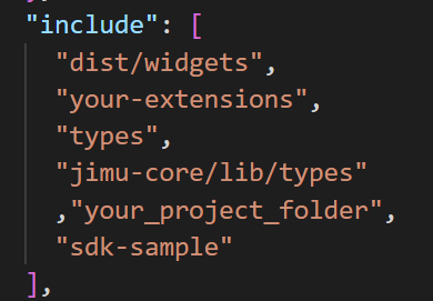

The solution for this is documented under "Why does VS Code show errors in my custom widget?" https://developers.arcgis.com/experience-builder/guide/frequently-asked-questions/
Adding my project folder name to the `tsconfig.json > include` worked for me.

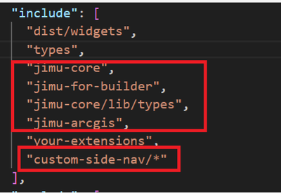

For me, I had to add 'jimu-core' and its subsequent dependencies to my 'ts-config' file.
Additionally, I needed to include my widget folder in the 'ts-config' file.

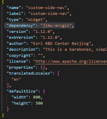

Furthermore, I added the following line to the 'manifest.json' file: 'dependency': 'jimu-arcgis'.
tsconfig
manifest.json
