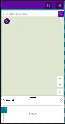

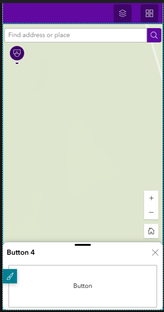

I have tried to create a button widget over the map area instead but when you select it, it just wants to open another button as per screen grab below.

This is what it looks like if I create a button.

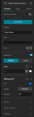

Set up the buttons content similar to this and link to the desired URL/page

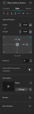

Set up the buttons style similar to this (adjusting the button size and position as required)
