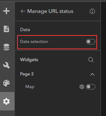

Hi @CameronLacelle,
You could toggle off the Data selection in General -> Manage URL status -> Data select, then after refreshing the app, the selection could be cleared.

Hi @CameronLacelle,

CameronLacelle
This is exactly what I needed, thank you!!

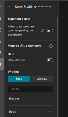

The home page is for browsing only, hence why all the fields are locked. If I select here, then move through to the next page 'Submit new point' I have the edit widget in a widget controller. If I open this then it automatically opens the form for the selected point - this is not the desired outcome.
I have used the url parameter setting like so:

EDIT: removed the link. Worked out a way round - you can add multiple instances of the same web map (and rename in web experience builder so it is clear what is the intended use of each) and then link the different page widgets to the instances. Has done the job 🙂
