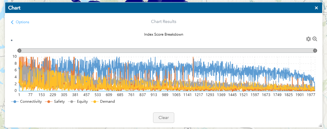

I am trying to replicate a chart widget that creates 4 linear series showing index scores for 4 fields in a feature layer representing bus stops. In Web App Builder, I would get a warning saying there are a lot of features, and that it may be slow. However, I can hit ok, and a chart will appear showing all records in the current extent (we have it set so the map filters the data to the visible stops within the map):

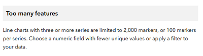

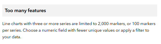

In Experience Builder, there appears to be a more strict limit on how many records can be displayed in a chart:
I set a data action to filter the data based on the extent, but that results in a chart only showing up when a user is zoomed in pretty far - I'd like to show all of the data in a chart at any extent.

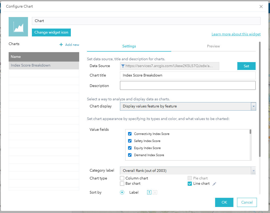

Here is the configuration for the Web App Builder Chart Widget:

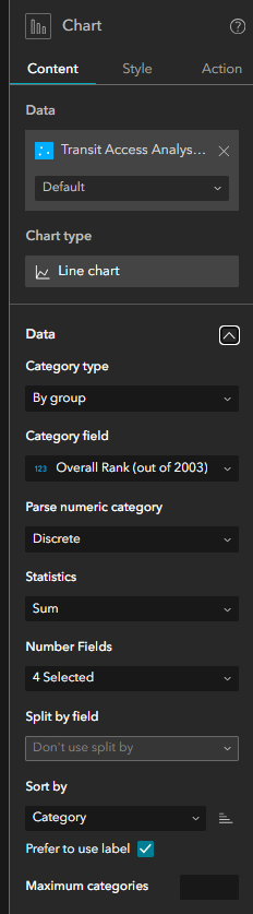

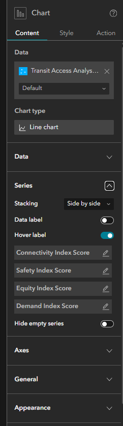

Here is my configuration for Experience Builder:
