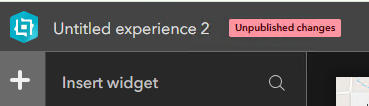

The name of your deployed application is taken from the Title in the header bar. You can change it there.
