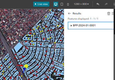

I am trying to change the flash color from yellow to another color. I am using a query widget then the map should zoom and flash to selected record. Please see screenshot below.
I have already tried the following, but didn't work.
  • Tried changing the color of the Highlight Fill and Outline under Feature Selection Colors (Option Section) in the Map Widget
  • Tried adding Action in the Query Widget "Records Created - Show on Map" with Use Custom Symbols setting
Has anyone encountered this concern? Appreciate any hint on this. Thank you very much.

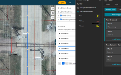

Use custom symbols work for me.
AndreasHall_0-1737468216449.pngAndreasHall_0-1737468216449.pngAndreasHall_1-1737468245968.pngAndreasHall_1-1737468245968.png
You talk about flash color, have you configured a flash action in any of your widgets?

Thank you for responding. Yeah, I did configure flash setting for all of my queries.
The custom symbols did appear (please see the cyan color in the screenshot below - red arrow), but whenever I select the queried record, the flash is color yellow (see blue arrow). I couldn't find if there are settings for configuring the flash color.

It does work as expected in 11.2 After you set the colors you have to go out of the query widget and make a new query and it'll show the color change.

Thank you for responding. The custom color did appear, but whenever I select a record, the flash color is still yellow. I also configure the flash setting. However, I couldn't find the settings for changing the color of the flash.
