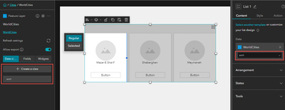

In the list widget, how can I set it so the cards are listed based off of the create_date (ie most recent info at the top)?
I see there is a sort option for this, but how can I make it so it's like this from the very start?

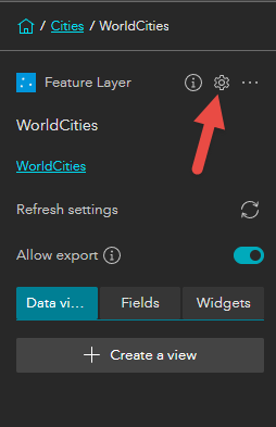

You can change the sorting of feature layer on the Data panel:
However, if you do so, the sorting will change wherever you use this data.
If you only want to use this sorting in the list widget, you can create a data view and use that view in the list widget.
