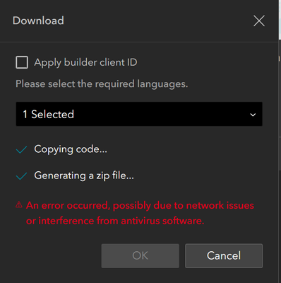

I just attempted to download and deploy an app to our local server and got the following message.  I am in Developer 1.18 and have used a few older versions and never seen this until today.
I am wondering if this is related to a recent update of my PC from Windows 10 to 11.  The reason I say that is I have successfully downloaded and deployed two different 1.18 apps prior to the Windows update.
Has anyone else seen this and know how to fix it?

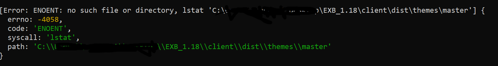

I ran that as an administrator and still failed.  I did notice this in the command prompt window.
I don't recall ever deleting that folder and I don't see the same folder being in 1.17 or 1.16.

This error suggests you created a custom Theme called Master at some point and then removed it. Or didn't migrate it when you updated Experience Builder. Things to try:
  • Add the Master Theme back to the your-extensions/themes folder with the client server off, then start the client server.
  • If you don't want to use this Theme anymore, check all your projects Themes and set them to something other than Master.
