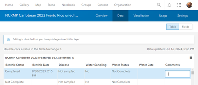

This could be caused by Esri's editing quirk. If you are the owner of the layer, you can edit records even when editing is disabled. This is what shows when I view the data for a layer that should be uneditable. I can still make changes to the Comments field, for example.
Have you tried using the app with another account to see if it's still editable?
