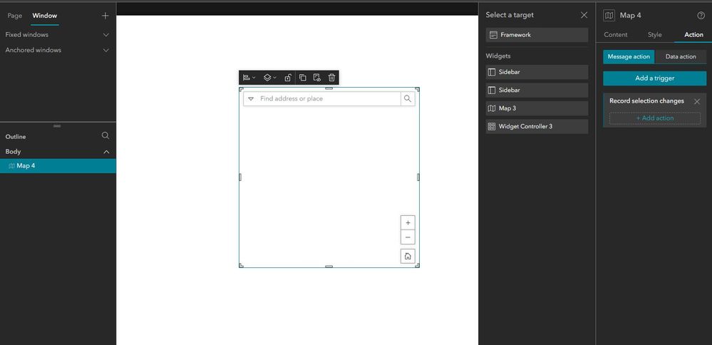

I'm wondering if this issue has revealed another underlying bug. In this instance, the widgets causing my issues no longer exist anywhere in the app and therefore could never be opened to be updated. I completely removed everything from the app, but these widgets remained in the JSON. The only place I can see some of them referenced is within the 'Action' list.
For example, after removing everything from my app, if I add a single map widget back and then go to Action > Record Selection, a number of widgets are listed that are nowhere to be found in the app. See the attached pictures. These are the widgets that caused my issues. They are present in the JSON but cannot be deleted in the app or opened to trigger an update to the newest version.
