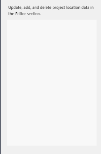

Hi! I have an Experience Builder app hosted on Portal 11.2. When I view the app, the edit widget looks like this:
When my users view the app, the edit widget is completely blank:
The app, its web map, and the Projects layer are all shared to a group that all organization users belong to. Editing is enabled in the layer settings and in the web map. Any idea why this is happening? Thanks in advance!

Have you double checked what user type/role your users are assigned?
HollyTorpey_LSA
That was it (a duh moment on my part). I forgot that although these users are Creators/data editors on AGO, they were only Viewers on Enterprise. Thank you!
