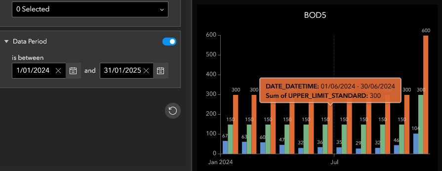

I am building an app with a bar chart widget. The grouping is by datetime and the time interval is 1 month. The date ranges of first 10 bars are correct, from the first day of month to last day of month e.g. 1 Jan 2024 - 31 Jan 2024, 1 June 2024 - 30 June 2024. But the date range of last bar is wrong 1 Nov 2024 - 1 Dec 2024. Are there any ways to resolve the problem?

@MatsHardy your date format is dd/mm/yyyy, right?
Which version are you working on? And do you use calendar-based for the time binning?
MatsHardy
Yes, I have chosen Calendar-based.
