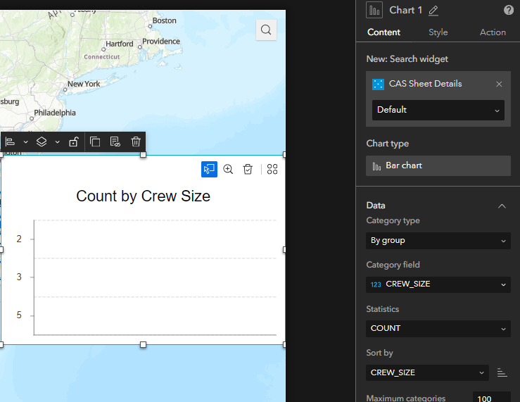

Hi All,
I am working with the Experience Builder within Enterprise v10.9.1.
Using a Map Service here that has its data in an SDE.
I can not get the Bar Chart Widget to work to produce a COUNT when using Category Type: By Group.
  • No matter what field type I try using, the chart is empty.
  • When I export the chart to a csv, I get the right counts for any category group I select.  No count is showing in chart.
Might anyone know what is going on?
Thanks!

Wei_Ying
@AdamRepsher_BentEar
Thanks a lot for your feedback! Looks like a bug, can you share the data for us to further investigate?

Wei_Ying
Hi @AdamRepsher_BentEar ,
Thanks for sharing details. Considering you are using Enterprise v10.9.1, it might be a bug that accessing non-hosted feature services. Could you open Developer tools - Network of the browser, see if there is an request failure?

TrisKent
Did a test in Enterprise 11.3 and it works fine, just not in our earlier version of  10. something
