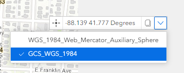

The default behavior of the OOTB ExB Coordinates widget works this way:
(view in My Videos)
If you place a pin, then the number stays for copy functionality.
The only exception is that certain WKIDs do not get values from mouse hover, so the coordinate values can only be obtained from a pin drop.

If you can verify that the Widget works with WKID 4326, that will be very appreciated. I'm trying it to work with WKID 4326 but it only works with placing the pin.
Regards.
TonghuiMing
I tried 4326 and it works fine on mouse hovering
CameronLacelle
hover coordinates does not work for UTM 17N (and I assume other UTM as well)
Stefan_Thorn
it depends on the coordinate system wkid that is used for the basemap. it will show coordinates while hoovering when you also add the same wkid to the widget.
update: but is it not working for all. i.e. I used a luxembourg webservice (esri lux) as basemap but still need to add a pin to get the coordiantes. while using a rd new (esri nl) basemap it went well.
