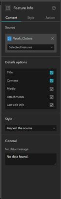

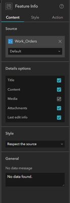

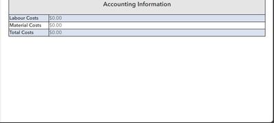

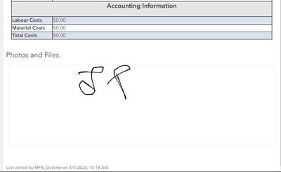

I appreciate your feedback but I don't believe it's a problem with the feature service version as the attachments display just fine when the Feature Info widget is set to display my "Default" version of the feature layer. The problem occurs when I change this data source to the "Selected Features" option. When using selected features, attachments won't display as a list or gallery. Additionally, the "Last Edit" note does not appear when using the Selected Features option but displays just fine when using "Default".
I've attached some photos below that show the options available in Experience Builder when selecting the Default option for my data source versus the Selected Features option, as well as the result that both produce.
Default OptionsDefault Options
Default ResultsDefault Results
Selected features OptionsSelected features Options
Selected features ResultSelected features Result
