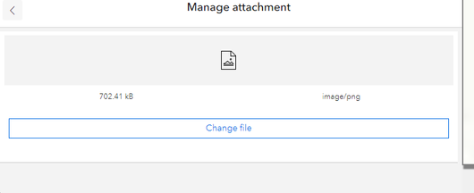

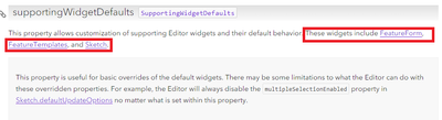

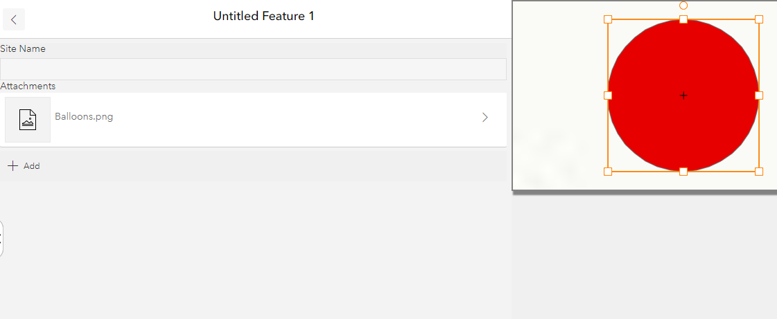

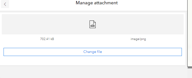

Hi, it looks like the attachments widget now used by the editor widget will show thumbnails if the displayType property is set to 'preview'.  Any guidance on how to best set this in a 4.x widget for Experience Builder?  Perhaps using Editor::supportingWidgetDefaults?

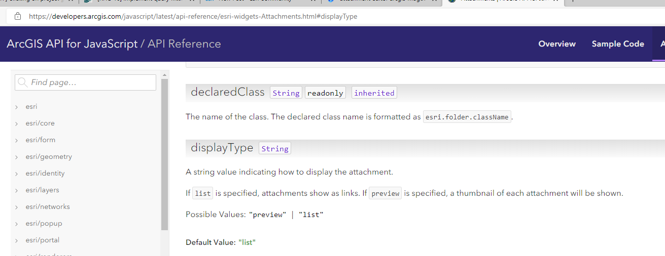

If I understand your question correctly, you would like to set the displayType property of the attachments widget used by the editor widget to "preview".
The editor widget in ExB dev samples is actually the component imported from the jsapi. According to the jsapi docs, the displayType property of the attachments widget is default as "list"
and the editor component does not support override default properties of the attachments widget for now.
So currently, if you want to "preview" those thumbnails, you can use the attachments widget separately instead of using the one embedded in the editor widget.

We don't have any specific samples in ExB for the attachment widget yet, but you could refer to this page (https://developers.arcgis.com/javascript/latest/api-reference/esri-widgets-Attachments.html) for detailed information (interfaces and samples). Hope it helps!
