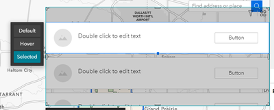

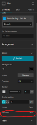

By sidebar, I assume that you have a List Widget inside a sidebar. There are a couple different ways to get to something like you want. The following steps allow you to make your list items look different depending on if they are unselected, selected or if the user is hovering.
In List widget, settings panel hit selected or hover.
Then Custom and accept warning
Redesign your list as desired. Switch between states with buttons on side of list.
