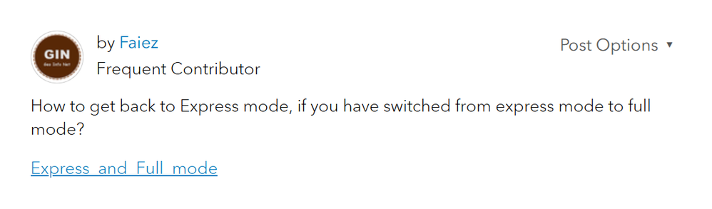

How to get back to Express mode, if you have switched from express mode to full mode?

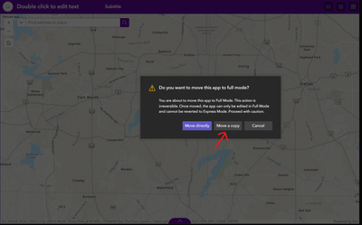

Once a project is converted to Full Mode, it cannot go back to Express Mode. It is recommended to copy your project before conversion. There is a popup box that should trigger before turning off Express Mode that will allow you to convert a copy of your project.

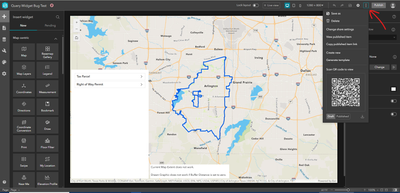

Copying a project is very easy. In the project select screen, you can hit the three dot menu and click Duplicate.
In the Build Mode find the vertical three dot menu in the Header and click Save As.
And if you are switching out of Express Mode, you can click Move A Copy.
