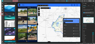

Can you please elaborate on what is build mode and the procedure to select the theme in build mode?
JeffreyThompson2
MVP Frequent Contributor
The build mode is this screen where you can actually construct your Experience. To select a theme, click the palette icon and select the theme of your choice in the sidebar. If you have made a custom theme, it should be in this list.
