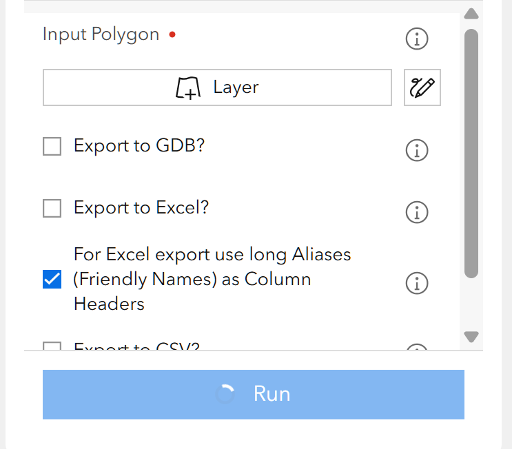

Analysis Widget hanging with a spinning Run in Chrome only
1040
6
09-02-2025 07:14 AM
DougBrowning
MVP Esteemed Contributor
Analysis Widget hanging with a spinning Run in Chrome only.  Edge works no problem.  We tried all kinds of logins etc but Chrome is not happy.  Anyone seen this?  The ExB is in AGOL and the GP service is portal.  We get the popup window to login to the Portal fine.  Tried 5 different computers.
Our old tools that are on a 11.3 standalone server also work just fine in Chrome.  So I think its something with the portal tools in a AGOL ExB?
Edit we see now that Edge and Chrome is blocking the popups as it goes into an infinite login loop to the portal.  So looking like something with the Analysis widget not liking pass through login?
