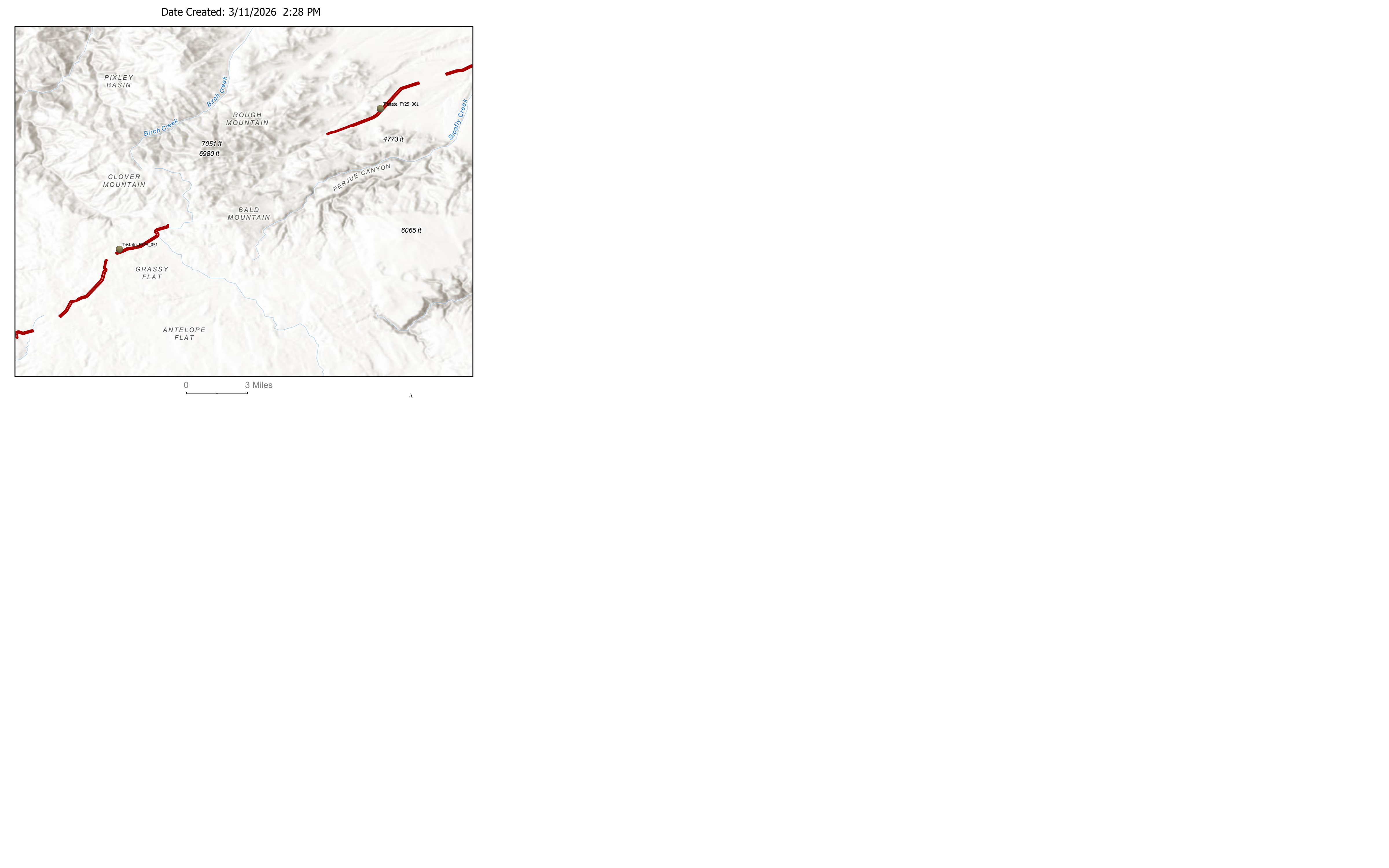

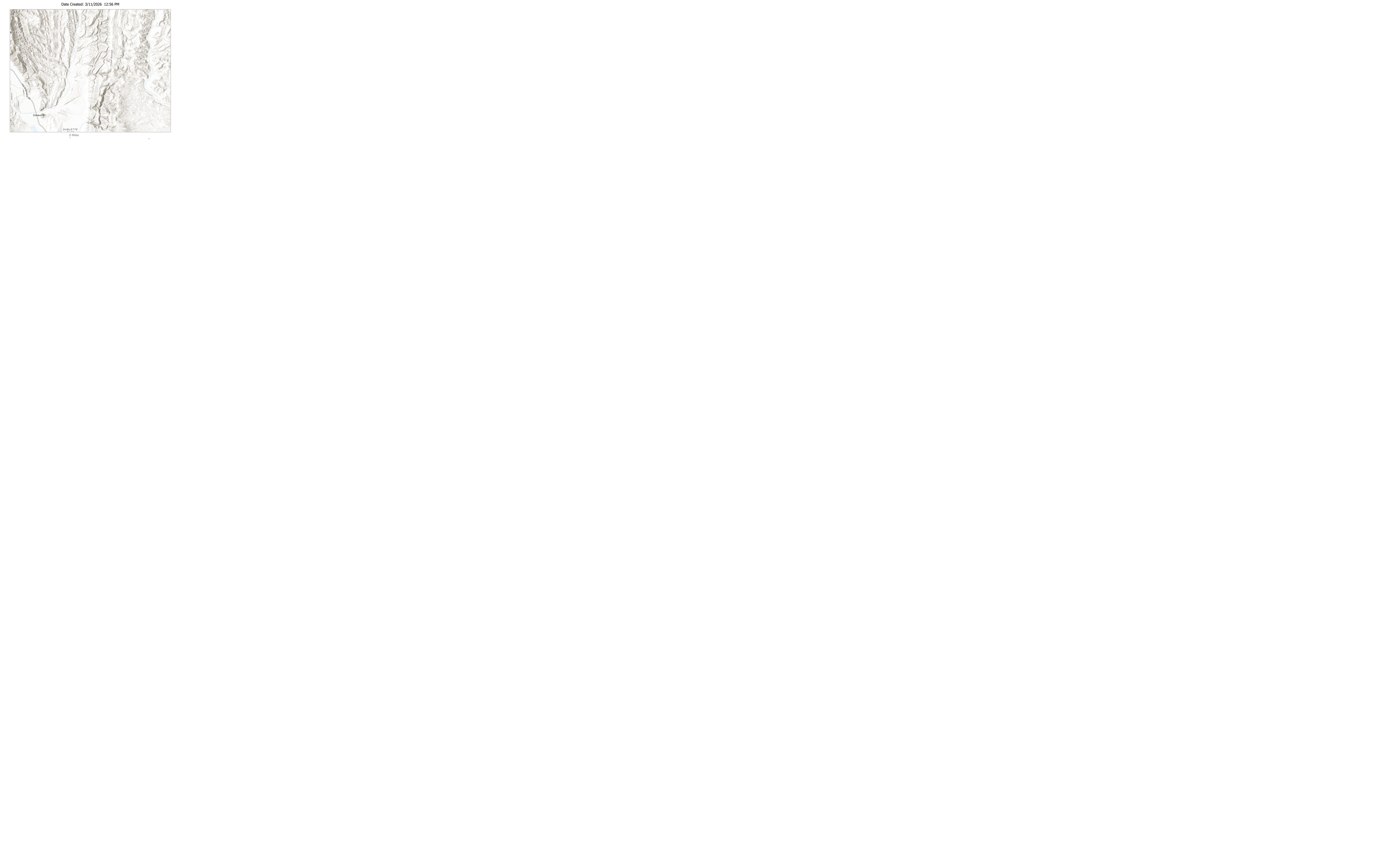

Finding some random polygons fail to be sent to the geoprocessing tool from the analysis widget.  When looking at the data that gets sent into the tool via Get Parameter and passed into a GDB it creates a FC but there are no records in it.
So I get a blank map when coming from Analysis widget.
But that exact same polygon from the same source works just fine when coming from ArcPro.
If I export that polygon to a GDB then upload that GDB to ExB and run it then it also works just fine.
Sorry images are not attaching here today for some reason.
It is a multipart polygon but we have other multipart from the exact same layer that work just fine.
Any ideas what can be wrong here?  We see again and again that some polygons just refuse to work in the Analysis widget.  I can demo any of these needed.  Thanks
